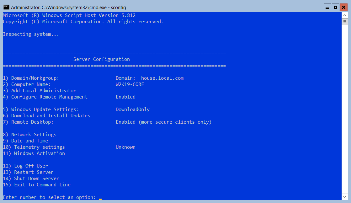

    1.After installing Server Core, ensure that the server has a valid IP-Address, Subnet Mask, Gateway, and a computer name that matches the naming conventions. The easiest way to do this is to use the sconfig command (machine is in the workgroup).
    2.According to the prompted options, type 15, click Enter.

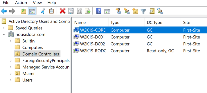

    10.After restarting, we can see the information by running sconfig on this server core ( machine VSTEPY89VM is in the domain named a.lab) and you can see in ADUC that this Server Core has joined the domain on the first DC with GUI.
