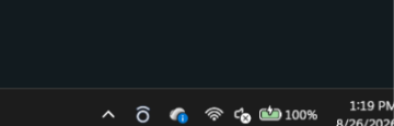

My microphone hasn't been working for almost a week now. The icon is just muted and blank even after contacting Microsoft for help. I'll snd a screenshot of what it looks likeUser's image

    Hi. I'm David, and I'm happy to help you.
    To be able to assist you better, please clarify the following:
    • Is the microphone internal or external?
    • If it is external, does the microphone have a standard audio connector (Jack connector) or a USB connector, or is it connected via Bluetooth?
    Also, share a screenshot of your system information.
    • Press "Windows + R", type msinfo32 and press Enter.
    Maximize the window and use the shortcut "Windows + Shift + S" to use the screenshot tool.
    Looking forward to your reply.
  2. Kapil Arya 38,571 Reputation points Volunteer Moderator
    2026-08-27T10:59:26.9966667+00:00
    -Check and confirm if Microphone access is enabled at Settings > Privacy & security > Microphone.
    -You can try setting your microphone as default. Run mmsys.cpl command, and then select your microphone. Click on Set default.
    -Go to Settings > System > Sound, click on the Input devices option present under the Troubleshoot common sound problems.
