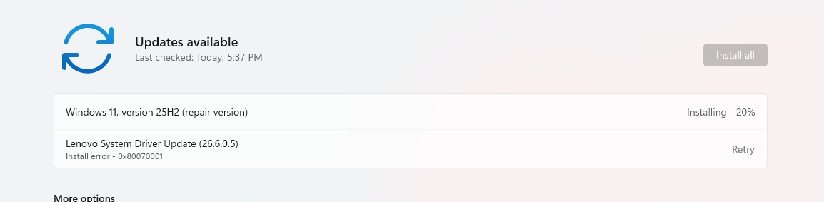

The problem started when I wanted to install these two updates, when it gets to 8%, I get a notification saying, my pc doesn't meet requirement for windows 11, but when I use pc health check and whynotwin11, they say it is compatible, secure boot status was off, I turned it on...the TPM status is "maintenance task is still running"...so I've been trying to make it say "ready for use", then I discovered regedit is not opening, I've been trying ways to open it, in order to try and change the TPM's status and hopefully then the updates can go through...I'm scared to have to install another window and possibly lose all my data, I've been avoiding that...these are all step I have been following on Youtube...I don't know anything about any of this
