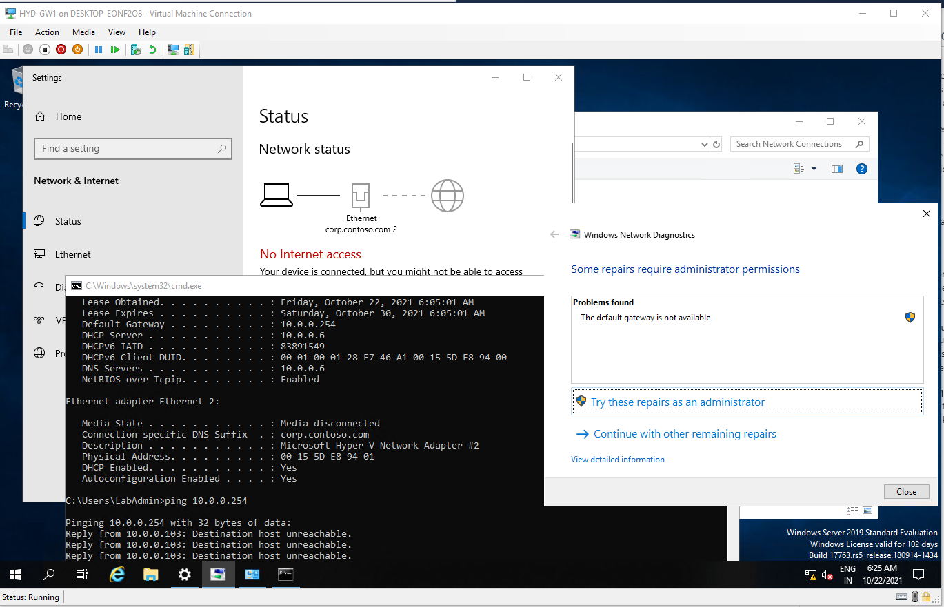

I have downloaded the Windows and Office Deployment Lab Kit and installed. I have followed the instruction mentioned in Lab Kit_21H1_lab guide_v3 and Lab Kit_21H1_set up guide_v3. But I saw that none of the VM is connected to internet. Please check the screenshot and guide me what configuration I need to follow to connect to Internet. Please check the screenshot of the VM HYD-GW1. From the screenshot we can see that Gateway is not reachable.
Thanks in advance!

    What hypervisor is being used? Please post an unedited ipconfig /all

    If I understand correctly, you enabled hyper-v feature in win10 computer, however, the guest OS cannot access Internet, right? Please correct me for any misunderstanding.
    For win10, after we we enable hyper-v, an internal virtual switch named Default Switch is created, which provides NAT and DHCP functionality. If we connect guest OS to this virtual switch and host OS is Internet accessible, the guest OS can access Internet automatically. There is no need to configure/setup any DHCP server any more.
    In our situation, the guest OS' IP is 10.0.0.103 and the DHCP server IP is 10.0.0.6 and what about 10.0.0.253 (is it another guest OS, acting as gateway)? If possible, we may connect all the guest OS to the Default Switch (Switch Type: Internal) to see if it helps. In the problem persists, could you help to share more details? For example, what kind of virtual switch (external/internal/private) the guest OS is connected to?

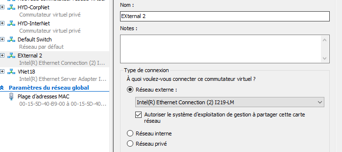

    I had the same issue. 1st of all the external switch I created was connected to my wired nic which was unplugged so I set that up to the wireless adapter then the 2nd nic on the gw machine is set to dhcp but it wasn't getting an ip address for some reason so I gave it a static one on my network range and it worked.

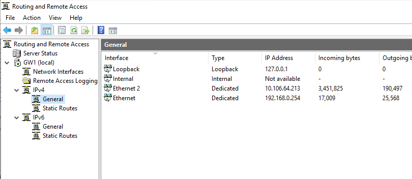

    I have the same issue, not Internet in my LAB. I change the private network for 192.168.0.0 cause my network is 10.106 . all my VM can connect to each other but no internet on GW1 and all others. routing and remote access is on2023-02-01 13-32-09

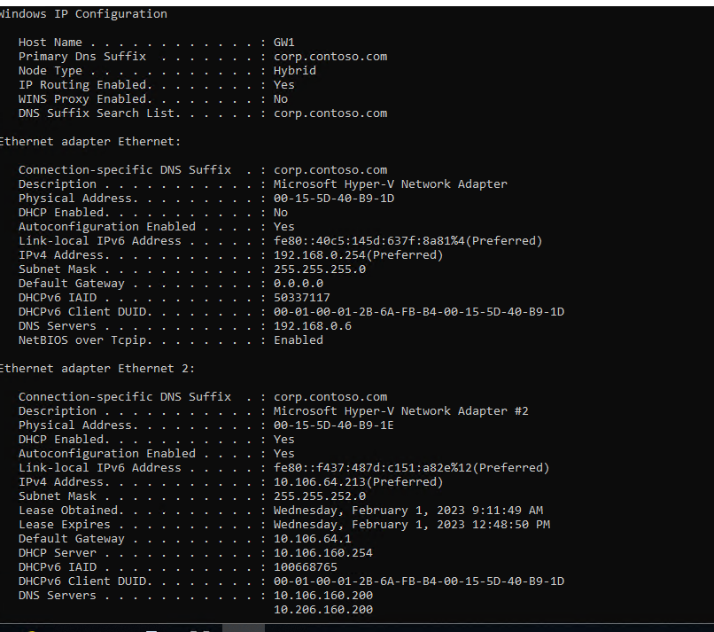

    I have the same issue. No Internet in all my VM. But all Vm can connect to each other. Ethernet 2 is my External. 2023-02-01 13-32-09
    2023-02-01 13-42-46
