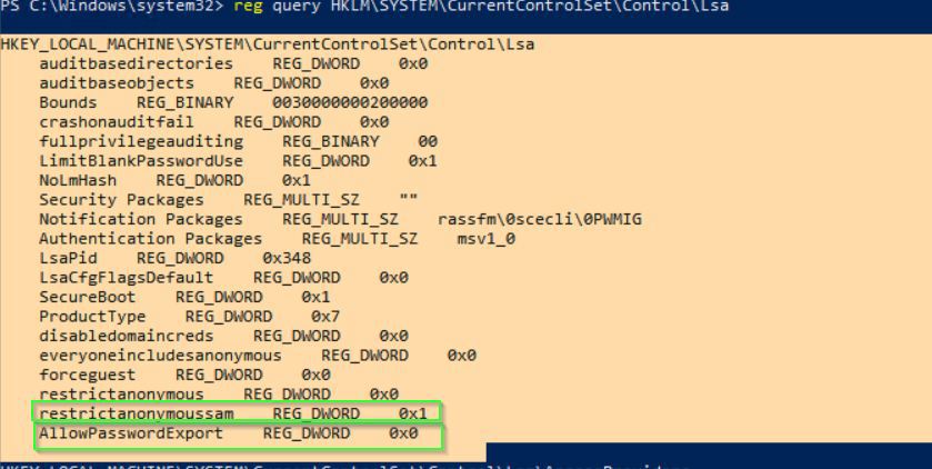

    There's also an older Microsoft-documented cause that matches the exact WRN1:7557 "Access is denied" message. On the target domain controllers, Microsoft has historically required HKLM\SYSTEM\CurrentControlSet\Control\Lsa\RestrictAnonymous = 0, and the Pre-Windows 2000 Compatible Access group must have the required Read and Enumerate Entire SAM Domain permissions on CN=Server,CN=System,DC=<TargetDomain>,DC=<TLD>
    That requirement exists because ADMT password migration still relies on older SAM/RPC access patterns that modern Windows security defaults intentionally restrict. I'd be careful about weakening those settings broadly, especially on Server 2025. They exist for good security reasons, so any required changes should be treated as temporary migration-specific exceptions and restored afterward.
    I also wouldn't start by assuming the PES service account simply needs more privileges. Since the user and computer objects are already being created successfully, the basic migration permissions and trust path appear to be working. Your exact error is more consistent with the legacy security requirements around PES, LSA Protection, or anonymous/SAM access.
    One other thing to keep in mind is Credential Guard and other virtualization-based security features on the system running ADMT. Microsoft documents compatibility issues there as well, and Server 2025 has much stronger security defaults than the platforms ADMT was originally built for.
    If you can post the output of these two commands from the source DC hosting PES, that'll probably tell us very quickly whether LSA Protection is part of the problem:
    reg query HKLM\SYSTEM\CurrentControlSet\Control\Lsa /v RunAsPPL
    reg query HKLM\SYSTEM\CurrentControlSet\Control\Lsa /v RunAsPPLBoot
