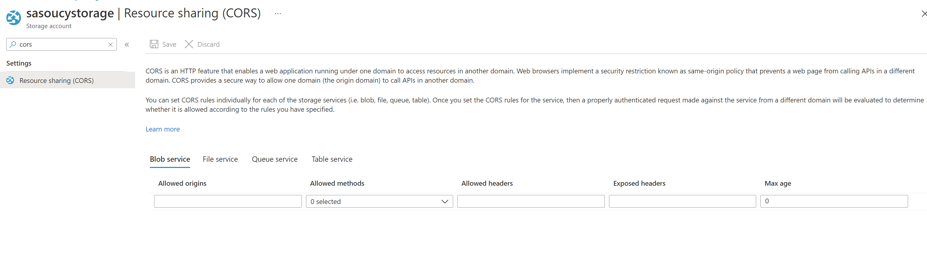

  1. Samara Soucy - MSFT 5,141 Reputation points
    2021-10-28T23:36:15.607+00:00
    Can you please check if there are any CORS policies set on the storage account you are trying to access?
