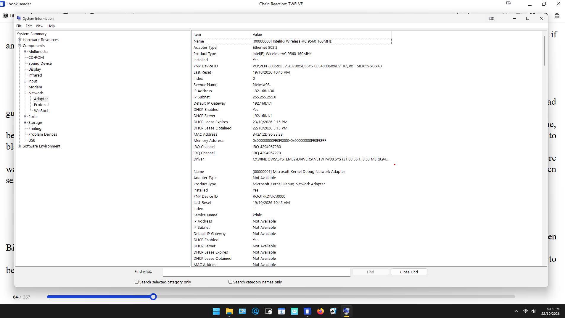

  2. Peter Woodhouse 60 Reputation points
    2026-10-22T05:28:24.9566667+00:00
    Screenshot 2026-10-22 161635
    Might have to wait a day or two before I can get the wi-fi adapter tested.
    Hope the scraanshot was ok.
    Peter
  3. Ivan B 125.8K Reputation points Independent Advisor
    2026-10-22T05:06:16.32+00:00
    Is the network cable showing as connected in your Windows settings?
    Search for msinfo32.exe in the search bar, take a screenshot, and post it here so we can see the correct laptop model or desktop configuration.
    Thanks
