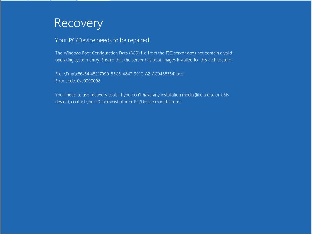

I have been working on getting Imaging setup in our environment for about two - three weeks now. I followed the blog by this site. I am attaching pictures. SCCM version: 2107 ADK: 10.0.19041.1 Host OS: Server 2019
  • PXE boot is enabled
  • x86 and x64 boot images are deployed to my db
  • WDS service is running

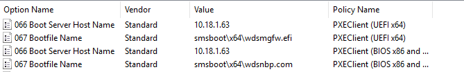

  • From my Hyper-V test box I get Clinet IP, Mask, and DHCP, Gateway. Configuration Manger is looking for policy and then then right after contacting Server PXE Boot aborted. Booting to next device.
  • SMS PXE and SMS TS logs attached. Please let me know any other Logs you would like see.
  • Pictures of desired settings also attached. Please let me know if there are any settings that you would like to see.!
  • List item143944-wds-running.png143951-windows-10.png143790-x64-boot-image.png143945-x86-boot-image.png
143907-dhcp-options.png143908-sms-pxe-log.txt143934-pxe-hyper-v-host.png143943-pxe-enabled.png

    2. deleted DHCP scope options especially on the VLAN where the SCCM Server is hosted. Spoke with my networking team and had IP helpers placed on VLANs outside where SCCM is hosted.
