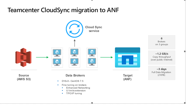

    What is the available bandwidth?
    We have some experience with large scale migrations using CloudSync and XCP, and depending on available bandwidth transfers can be performed quite fast (and often times faster than an offline sync -and-resync migration).
    For example; migration from AWS S3 source to ANF: 210TB in ~3 days.
    Both CloudSync and XCP can be used over ExpressRoute, its really up to the customer. CloudSync is a multi-source/multi-target service, whereas XCP is more optimized for direct NFS->NFS or SMB->SMB migrations.
    The migration path/tools should not dictate the end state, but rather the desired end state should dictate the migration path/tools
