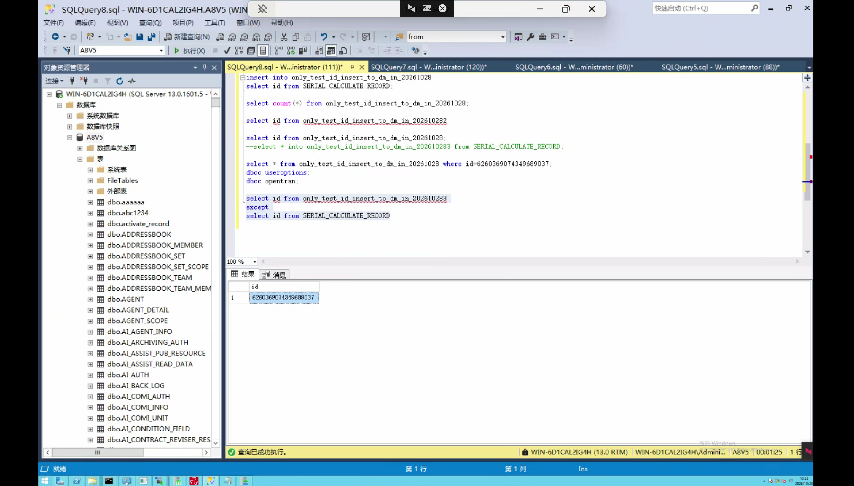

SQL Server 2016 RTM (13.0.1601.5), RCSI enabled.

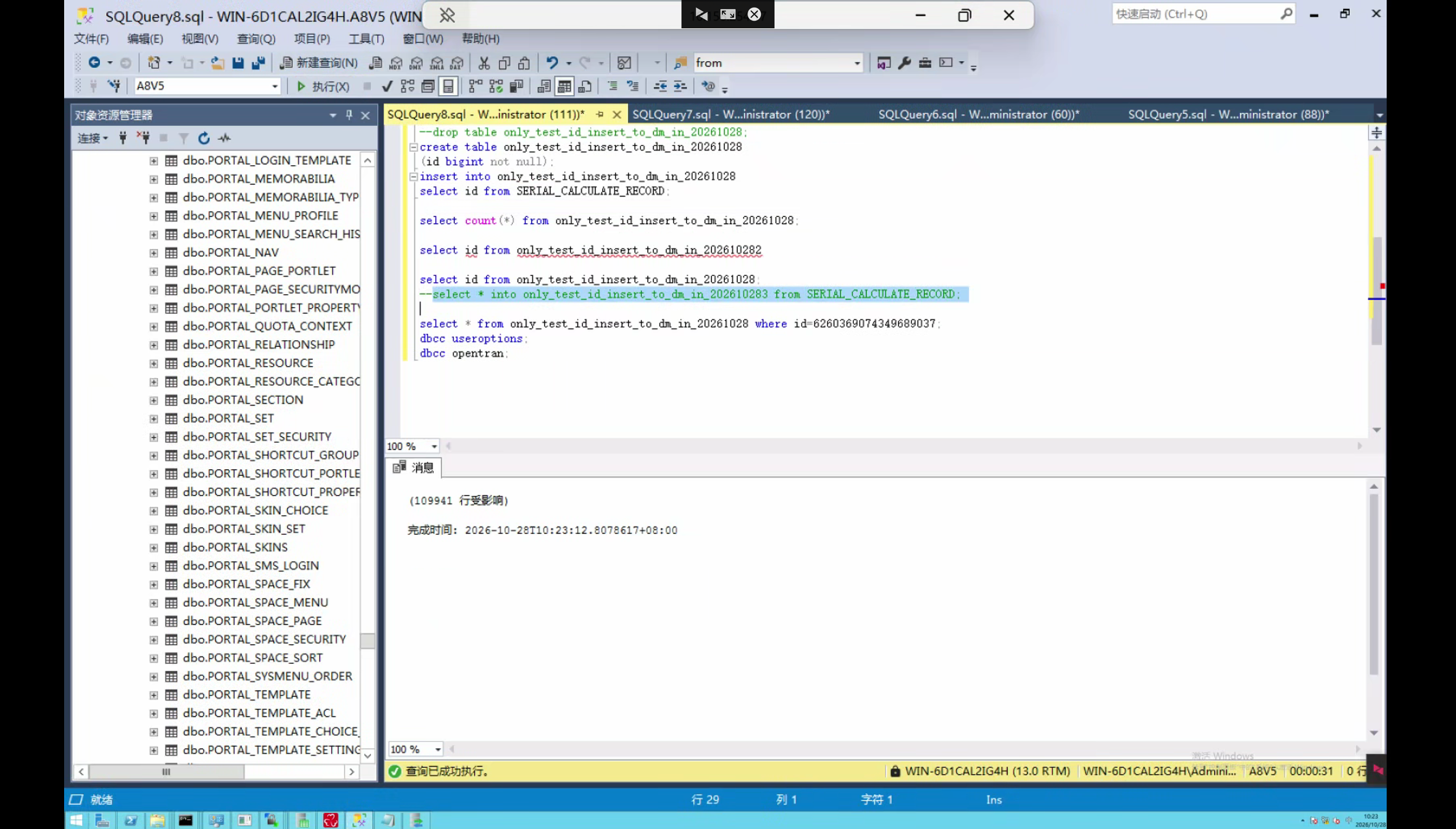

When doing `INSERT INTO backup_table SELECT * FROM source_table`, the backup table contains an extra data that no longer exists in the source table.
I have confirmed:
- No open transactions at the time.
- No concurrent INSERT/DELETE from other sessions during the full scan.
- Neither normal query nor NOLOCK hint can retrieve this ID from source table now.
I suspect this is a ghost record cleanup bug of RCSI full scan in SQL Server 2016 RTM.
Are there any known bugs matching this symptom? What diagnostics should I collect?
