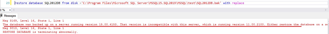

    I test this on my environment.
    DB2012----compatibility level 110(2012). I got the below error when I back the database on SQL 2019 and restore it on SQL 2012.
    SQL2012DB--- compatibility level 150(2019). I got the below error when I back the database on SQL 2019 and restore it on SQL 2012.
