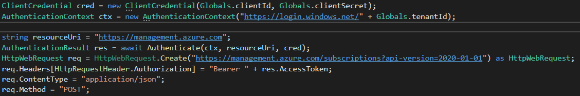

I am getting a 404 error when trying to get the entire list of subscriptions from azure. I am using the https://management.azure.com/subscriptions?api-version=2020-01-01 rest api. At first I thought it might be an issue with the resourceUri, but now I am starting to think it might be an issue with the rest api I am using. Is this not the correct version or am I missing something?145065-image.png

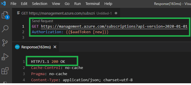

    I see that you are doing a POST request against the management URI. Can you please change the method to GET instead and try. Please refer to the doc here for more details, which specifies GET method for performing this operation.
    I did a sample test using REST Client extension in VS Code against the management URI and got the expected result when using GET as specified in the documentation. For POST, i see a 404 returned.
