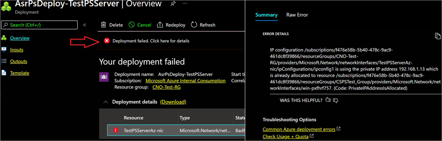

we are testing vmware on prime machine to cloud using ASR, the vm failed over to cloud but unable to fail back to on prim. subsequently deleted the cloud vm and started on prim vm and uninstalled mobility client etc, but the machine shows on ASR as "VMware tools are not installed for the selected VM" and unable to select for replication. the machine cloned with different SID still same. How we can clear any residual configuration data and start replicate again..

  1. Suhail TV 96 Reputation points
    2021-11-07T11:11:04.407+00:00
    Re installed the agent manually so it registered to the process server, now I am able to replicate the machine,
    https://learn.microsoft.com/en-us/azure/site-recovery/vmware-physical-mobility-service-overview
    the process server deployment error further investigation lead to subscription quota issue, the server template requires 8 core but our subscription supports on 4 core now, the error detail given below
    eyJ1cmwiOiAiaHR0cHM6Ly92c2Vydi1zZW50bmwwMS5hamUuYWUiLCAic2l0ZV9rZXkiOiAiYTA5YjUwMWY1NmY5ZThjYiJ9statusMessage": "{\"error\":{\"code\":\"InvalidTemplateDeployment\",\"message\":\"The template deployment 'AsrPsDeploy-test-v01' is not valid according to the validation procedure. The tracking id is '656cd198-4386-421b-a5f6-995634df8902'. See inner errors for details.\",\"details\":[{\"code\":\"QuotaExceeded\",\"message\":\"Operation could not be completed as it results in exceeding approved Total Regional Cores quota. Additional details - Deployment Model: Resource Manager, Location: UAENorth, Current Limit: 4, Current Usage: 0, Additional Required: 8, (Minimum) New Limit Required: 8. Submit a request for Quota increase at https://aka.ms/ProdportalCRP/#blade/Microsoft_Azure_Capacity/CapacityExperienceBlade/Parameters/

  2. Suhail TV 96 Reputation points
    2021-11-07T10:48:01.697+00:00
    further verification this is caused by limitation on trial subscription, the process server requires 8 core server but subscription service supports only 4 core..
