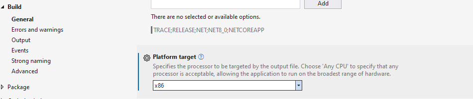

I have a legacy net solution, which has to be x86. But when using the form designer, I get an error since it detects that a certain control does not exist or its architecture is not correct. That control that gives the error is a custom control.
  • I can't hit the skip as it breaks the design.
  • It is solved by changing the project to any cpu, but I need it to be x86.
Does anyone know a solution to this problem? I need the designer to work on VS2022 with the project on x86 architecture.
