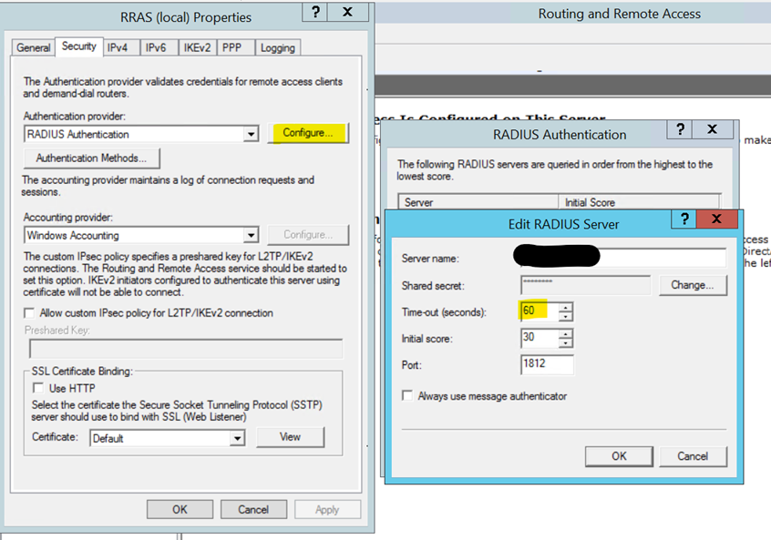

    3) During my own setup of this extension I have received this error when the request was timing out too soon, when the latest version of the extension was not installed, and when there were old certificates on the server that needed to be removed.
    If the request is timing out too soon, make sure that it's set to at least 60 seconds to give enough time for the request to succeed.
