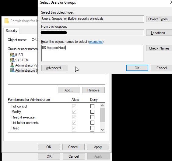

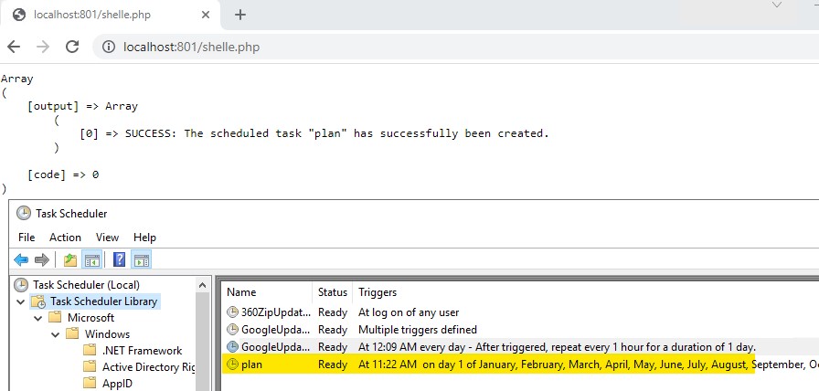

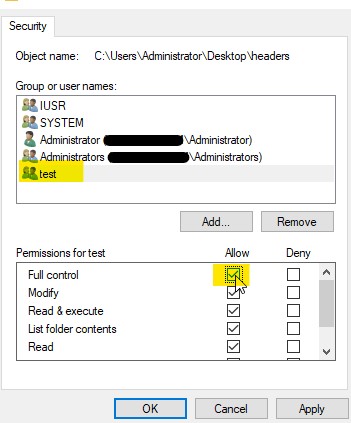

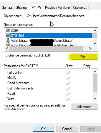

  2. Bruce Zhang-MSFT 3,771 Reputation points
    2021-11-05T03:36:22.983+00:00
    Hi @SWH-TW ,
    I tried to reproduce the issue but failed. It worked well on my server 2019. I just change the .exe file to chrome.exe.
    UAC was not involved in my testing. When I set the IUSR permission, it didn't work immediately but displayed a 401 error, which is not the same as your error. So I set permissions for the application pool test, both of which are full control permissions. Then it worked.
    So I think you can try to add "IIS Apppool\app pool name" and give it full control permission.
