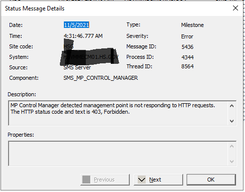

I have installed MECM and the Management Point is showing as Critical. I checked the Component Status error and the SMS_MP_CONTROL_Manager was showing an error as shown below:

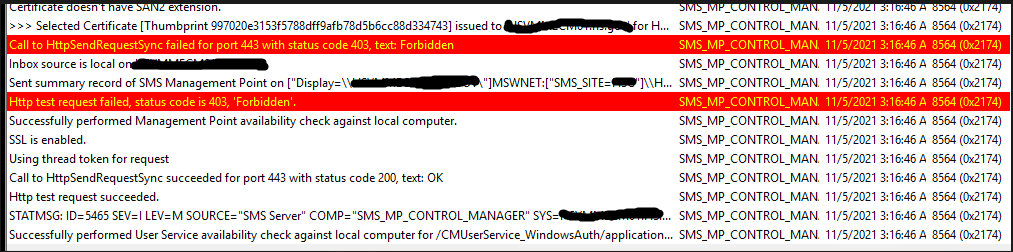

I also checked the mp_control.log. This showed the below error:

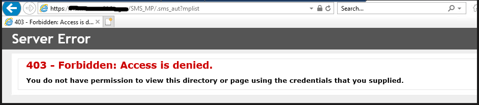

After this, I tried to access the "http://SERVERNAME/sms_mp/.sms_aut?mplist" and "http://SERVERNAME/sms_mp/.sms_aut?mpcert" but this was also showing as 403: Forbidden as shown:
I need to have MP communication Protocol as HTTPS. How do I proceed from here?

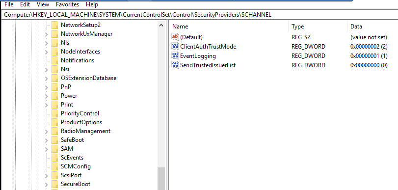

    I added the Root CA Cert in the ConfigMgr Site Communication Settings, and changed the registry settings in the location shown below, and it resolved the issue that was showing up.

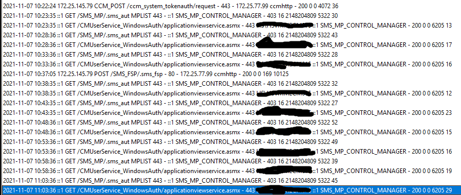

    2021-11-05T14:30:17.093+00:00
    This is due to cert related issue.
    Do you have cert selection in the IIS bindings? what is your site communication properties looks like? do you use CRL checking?
    Try to uncheck the CRL if you are not using in the site communication settings.
