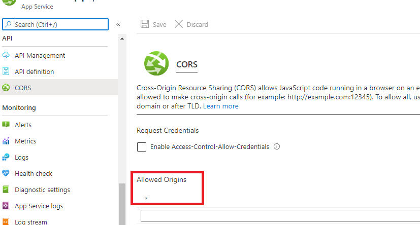

We have Swagger API deployed on Azure Web App.
When trying to call the Azure WebApp Swagger API from Logic App using the Http+Swagger operation , get the error
Failed to fetch swagger with error message: Invalid response.Ensure you have CORS enabled on the endpoint and are calling a valid HTTPS endpoint.
I have not set any Authentication or Authorization
Even in the API Settings , i have given path to the .json file as below
https://mysgwebapp.azurewebsites.net/swagger/v1/swagger.json
On the Azure Web App, for CORS, i have put Allowed Origins = * . Please see below pic

    Hello @MS Techie - I have confirmed with our Product Group that, as of this writing, the HTTP + Swagger Action is yet to support OpenAPI V3 spec.
    When a v2 spec is provided to the prompt, the Action is working as expected. While the team prioritizes the work of supporting v3 spec, if you feel that we should communicate this detail better via our docs, please consider opening a new issue under the documentation by using the "This page" button found at the bottom of page: HTTP + Swagger doc.
    I hope this info brings clarity to the issue observed above and helps with the planning of your project.
