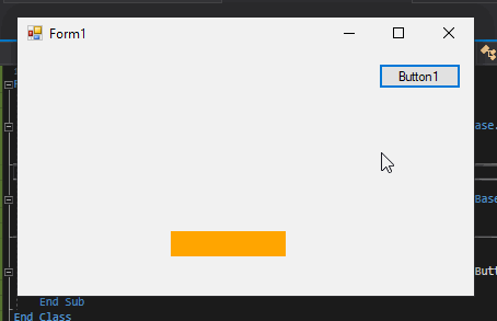

    I make some changes based on your code.
    Here is my result.
    Here is the code.
    GameBoard
        Public paddlecolor As Color = Color.Orange
        Private Sub GameBoard_Activated(sender As Object, e As EventArgs) Handles MyBase.Activated
            Paddle.BackColor = paddlecolor
        End Sub
    ColorChoose
        Private Sub Button1_Click(sender As Object, e As EventArgs) Handles Button1.Click
            GameBoard.paddlecolor = Color.Blue
        End Sub
        Private Sub Button2_Click(sender As Object, e As EventArgs) Handles Button2.Click
            GameBoard.paddlecolor = Color.Red
        End Sub
    Hope the code could be helpful.
    Best Regards.
    Jiachen Li
