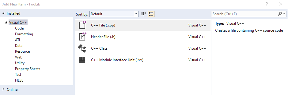

  1. RLWA32 49,636 Reputation points
    2021-11-09T14:12:00.427+00:00
    The wizard can be found in the Add New Item selection -
