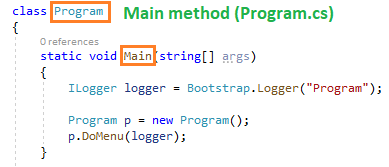

And the Main class is in another cs (Program.cs) file.
Do I call/put the class name (& method) inside the Function class inside Run method (as shown below)?
I am trying to understand how Function app gets called vs. how Main method is called within Function application.

    Inside the Function class, you will have a method called Run, there you can put your logic like what to do when the function is invoked. For example, in your case call an external endpoint, it doesn't have to be a REST endpoint.

    Like Jaliya mentioned, its usually the Run method but the main requirement is the FunctionName attribute which registers the function.
    As for how you would want to move the data itself, you would just use regular C# code and relevant SDKs as required. One thing you might want to consider is the function timeouts enforced based on the plan you are running on.
