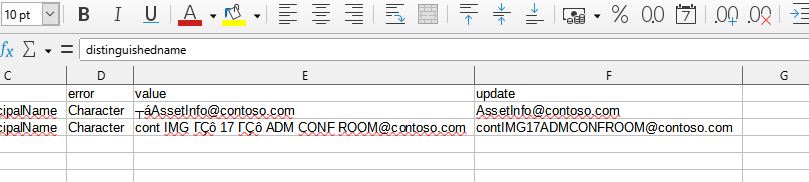

  1. Rich Matheisen 47,901 Reputation points
    2021-11-14T20:48:08.817+00:00
    If I've interpreted your problem correctly, this should result in (mostly) legitimate SMTP addresses:
    # Assuming no quoted strings are used in the addresses
    # and no comments are used in the addresses
    # and no "international" characters are used in the addresses
    # domain isn't expressed as an IP address "[xxx.xxx.xxx.xxx]"
    # THESE are what's valid in a SMTP address. Note that the range is INVERTED by the "^" at the beginning
    $InvertedValidCharactersRange = "[^A-Za-z0-9!#$%&'*+-/=?^_``{|}~.(),:;<>@[\]-]+"
    Import-Csv c:\Junk\BadIdea.csv -Encoding UTF8 |
        ForEach-Object{
            $_.Value -replace $InvertedValidCharactersRange, "" # remove everything that's NOT a valid character
    NOTE: There is no attempt to actually validate the SMTP address. This is purely a character deletion bit of code!

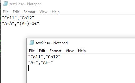

    I have a CSV file
    Probably an encoding problem. Try this.
    $update = Get-Content -Encoding UTF8 -Path "c:\temp\test1.csv" -raw
    $update
    $hash = @{}
    $hash."'" = ''
    $hash."&" = ''
    $hash."(" = ''
    $hash.")" = ''
    $hash." " = ''
    $hash."/" = ''
    $hash."\" = ''
    $hash."Â" = ''
    $hash."– = ''
    Foreach ($key in $hash.Keys) {
        $update = $update.Replace($key, $hash.$key)
    $update
    $update | Out-File "c:\temp\test2.csv"
  2. Stephen Peterson 36 Reputation points
    2021-11-12T18:15:15.42+00:00
    After I run it through the script, the output file typed at the command prompt show some of these as a question mark.
    I may be able to just run it through the script again to see if I can eliminate the "?"
    Ill let you know how that goes
    Steve

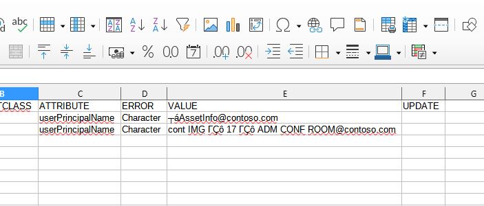

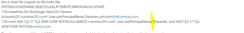

  4. Stephen Peterson 36 Reputation points
    2021-11-12T21:12:39.83+00:00
    Here is the code Im using
    $idfixfile = Import-Csv -encoding UTF8 $home\Documents\orignal.csv
    $outfile = "$home\documents\fixed_file.csv"
    $output = @()
    $lastoutput = @()
                                    $hash = @{}
                                    $hash."'" = ''
                                    $hash."&" = ''
                                    $hash."(" = ''
                                    $hash.")" = ''
                                    $hash." " = ''
                                    $hash."/" = ''
                                    $hash."\" = ''
                                    $hash."Â" = ''
                                    $hash."– = ''
                                    $hash." " = ''
                                    $hash."ΓÇô" = ''
                                    $hash."-" = ''
    Foreach ($entry in $idfixfile){
                                    $distinguishedname=$entry.distinguishedname
                                    $objectclass = $entry.objectclass
                                    $attribute = $entry.attribute
                                    $newerror = $entry.error
                                    [string]$oldvalue = $entry.value
                                    $update = $oldvalue
                                    $obj = new-object psobject
                                    $obj | Add-Member NoteProperty 'distinguishedname' $distinguishedname
                                    $obj | Add-Member NoteProperty 'objectclass' $objectclass
                                    $obj | Add-Member NoteProperty 'attribute' $attribute
                                    $obj | Add-Member NoteProperty 'error' $newerror
                                    $obj | Add-Member NoteProperty 'value' $oldvalue
                                    $obj | Add-Member NoteProperty 'update' $update
                                    $output += $obj
                                 $output | export-csv -Encoding ASCII $outfile -nti
