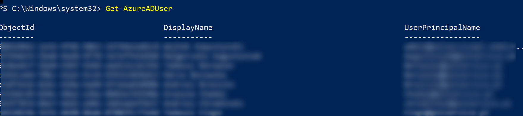

When I try to get only Get-AzureADUser I've got results:
Any suggestion?

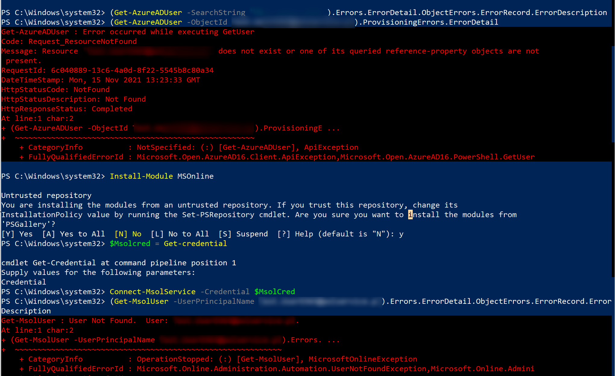

  1. Andy David - MVP 157.4K Reputation points MVP Volunteer Moderator
    2021-11-15T12:45:11.593+00:00
    Ok, I would verify that you are logged in with an account that has permissions to run these queries first. I know that sounds obvious, but thats the sort of error you would get if not.
  2. Vasil Michev 119.5K Reputation points MVP Volunteer Moderator
    2021-11-15T12:59:27.777+00:00
    The syntax/properties you are trying to reference are for the Get-MsolUser cmdlet, you cannot just replace it with the Get-AzureADUser and expect it to work :) Errors/ErrorDetails and so on is not exposed via the Get-AzureADUser cmdlet.
  3. Andy David - MVP 157.4K Reputation points MVP Volunteer Moderator
    2021-11-15T13:04:15.27+00:00
    Ok, but if its failing with Get-AzureADUser -ObjectId <ObjectID> with that error, then the UPN you are entering must not exist.
    try this as a test:
    Get-AzureADUser -SearchString <DisplayName of User>
  4. Limitless Technology 39,916 Reputation points
    2021-11-16T08:45:38.4+00:00
    Hi there,
    This error means that you are connecting to Azure AD without privileges or you are connecting to the wrong Tenant ID. To ensure connection to the expected Azure AD Domain, the tenant ID must specified. The tenant ID can be retrieved using the Get-AzureRmContext cmdlet. Then indicate this ID and try running the command again.
    --If the reply is helpful, please Upvote and Accept it as an answer--
