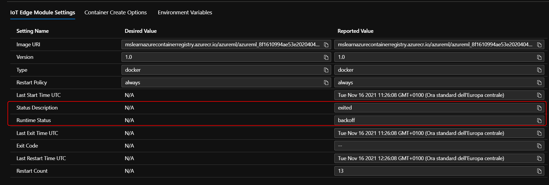

The issue I need support is the following: after deploying the ML model as container to the Edge device (in this case a Ubuntu VM created using this template), the ML module reported an error:

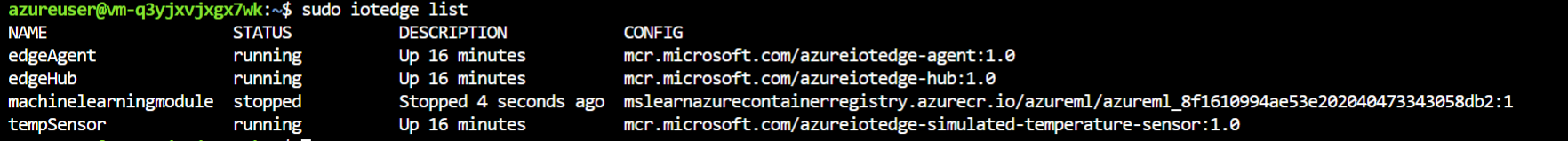

No logs are displayed, neither through VM SSH access, nor through the Portal.
The only information that I found out is this one:
I checked multiple times the correctness of the image URI for the ML module, and I'm pretty confident that it is, since the ACI is based on it and the Web Service test was succeded.
What could be the problem here?
