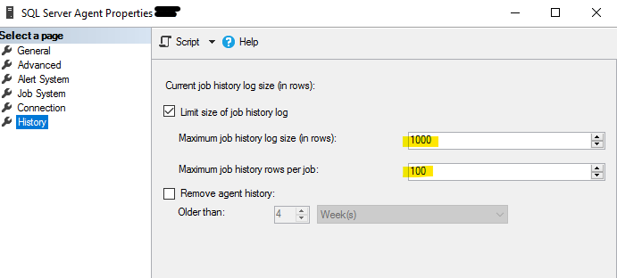

    I did a test:
    First, let's take a look at the default configuration:
    Under this setting, I can see the job history. For you to see more clearly, I executed the following script to view the number of each job.

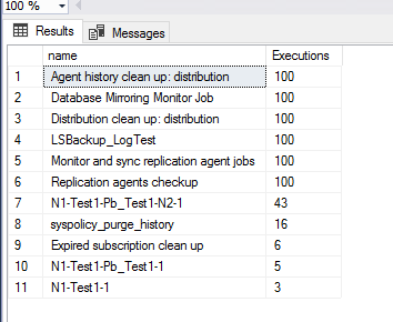

    SELECT j.name, COUNT(*) Executions
    FROM msdb.dbo.sysjobs j
    INNER JOIN msdb.dbo.sysjobhistory h
    ON j.job_id = h.job_id
    GROUP BY j.name
    ORDER BY Executions DESC
    Results:

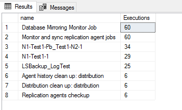

    You can see that my number is far more than 200, and now I changed the maximum number to 200.
    It will clear part of the log but not all of it. After all, if you set a maximum value, this value will not be 0.
    So I ask my question, do you have any maintenance plan that contains the history of deleting this job.

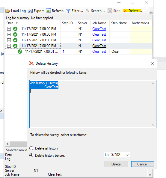

    1. Use the UI
    Delete the history of the specified job you want to delete.
    2. Use sp_purge_jobhistory
    The script is as follows:
