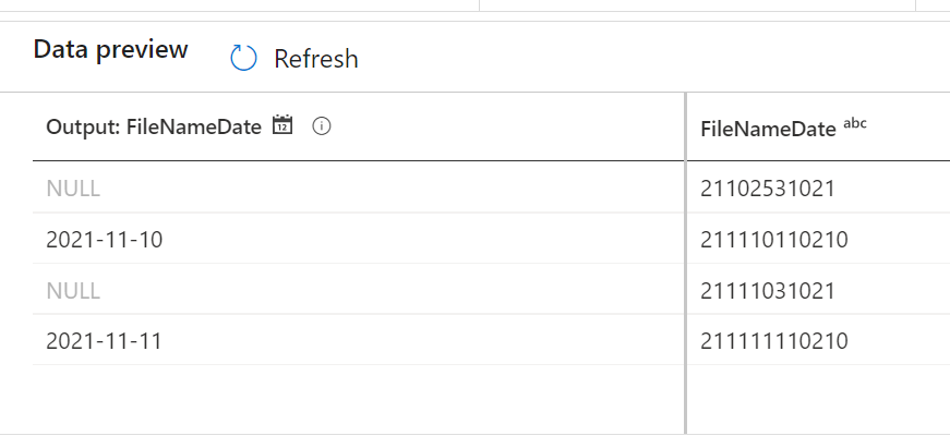

I would like to convert my INT datatype column to datetime.
Example :
I can get the date out of my column. Can you please help me how to get the timestamp along with the date.
Thanks in advance!

    FileNameDate is a text column, not an integer. That makes sense because an regular 32-bit int cannot hold a full date value (YY,YYM,MDD). Hence this is just a string parsing problem.
    Unfortunately your time isn't in a consistent format so there isn't going to be a "correct" way to do this. Given the following value: 12345, is this 12:34:05, 1:23:45 or something else? Unless you have the full 6 digit timestamp you are going to have to make some decisions on how to interpret the value.
    Given just your first value 21102531021 if you assume the first 6 digits are the date then this results in 10/25/2021. That leaves the remaining time of 311021 which is not a valid hhmmss value. Is this a Unix timestamp or something that represents ticks?
