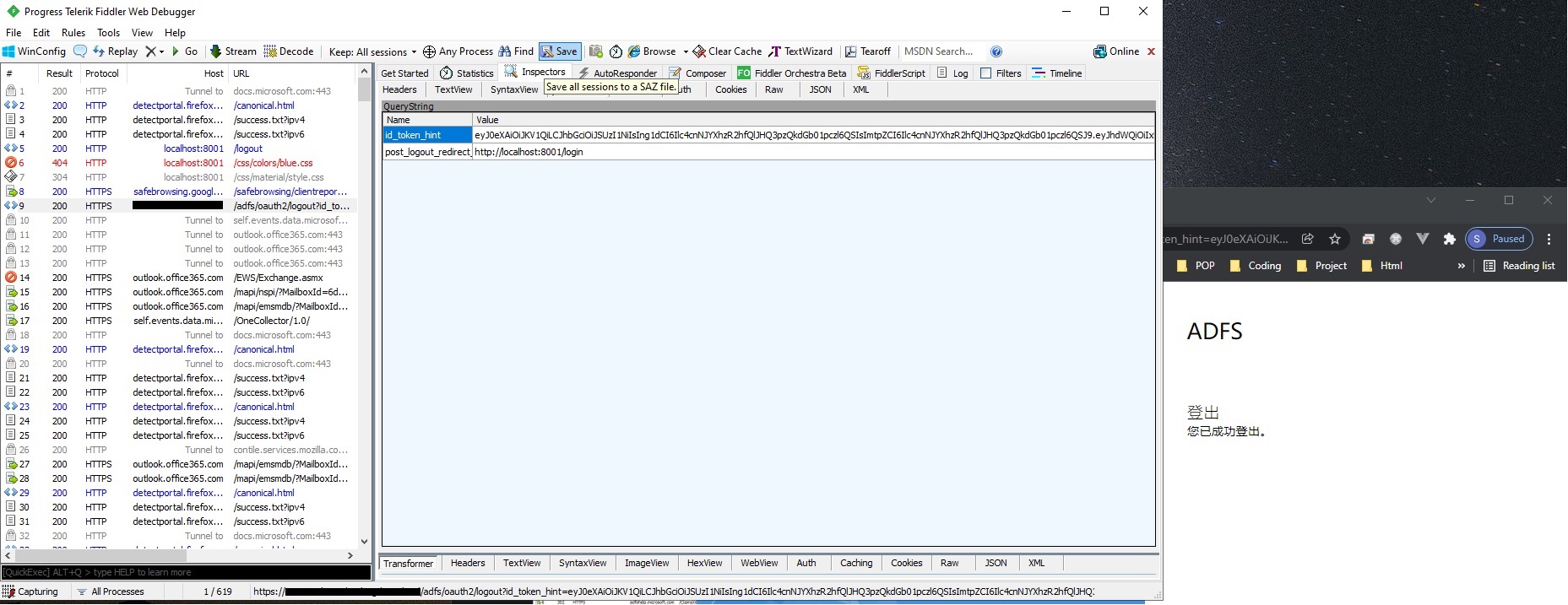

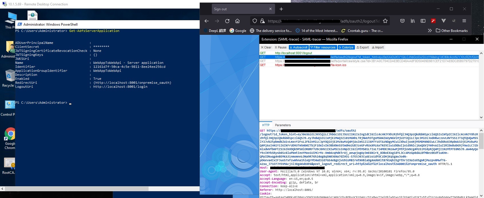

    When we given parameter id_token_hint and post_logout_redirect_uri to AD FS Single logout, but not redirect action to our portal( parameter setup in LogoutUri in photo 2 ). Only hold as AD FS login page ( Because of tiny difference from graph OAuth that graph will redirect back to our portal ).
    So, is that important of our server hostname (remove data) is using?
    If yes, i will clone the environment for testing this case.
    Enclosed below capture with missing :

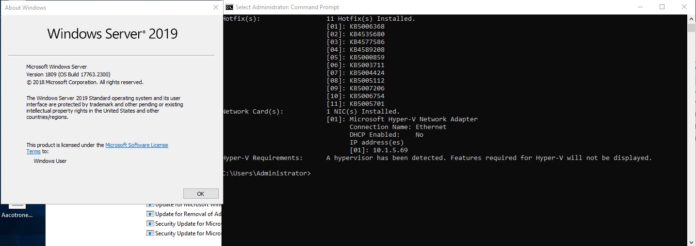

    Photo 1 : On-premise AD FS server 2019 Hotfix state :
    Photo 2 : On-premise AD FS server 2019 LogoutUri :
