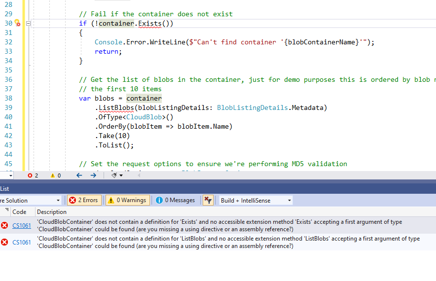

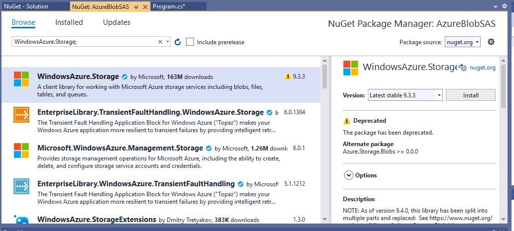

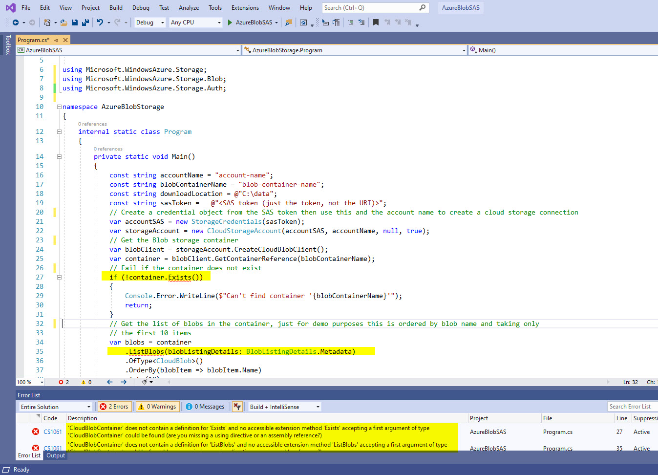

  1. shiva patpi 13,366 Reputation points Microsoft Employee Moderator
    2021-11-24T23:21:24.723+00:00
    Hello @Brian Ho ,
    Can you try installing Microsoft.WindowsAzure Nuget Packages using the solution explorer ?
    Go to Solution Explorer -> Select References -> Right Click -> Manage Nuget Packages -> Search for WindowsAzure.Storage
    In the search list, install the first one i.e. WindowsAzure.Storage.
    Regards,
    Shiva.
