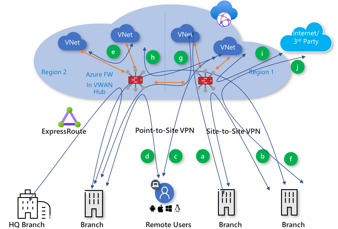

    1) Would it be possible to connect multiple hubs from the same region to a vWAN hub?
    This is possible. As seen from the below architecture,
    These Secure Hubs can be in the same region or a different region. Irrespective of that this can be connected to the vWAN.
    2) What are the design and routing considerations?
    Please remember that Inter-hub processing of traffic via firewall is currently not supported. Traffic between hubs will be routed to the proper branch within the secured virtual hub, however traffic will bypass the Azure Firewall in each hub.
    For more design considerations regarding this setup, please refer to this document.
    Please let us know if you have any further questions and we will be glad to assist you further. Thank you!
