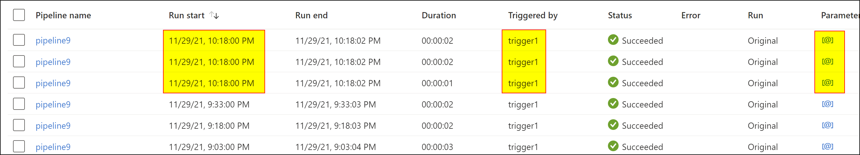

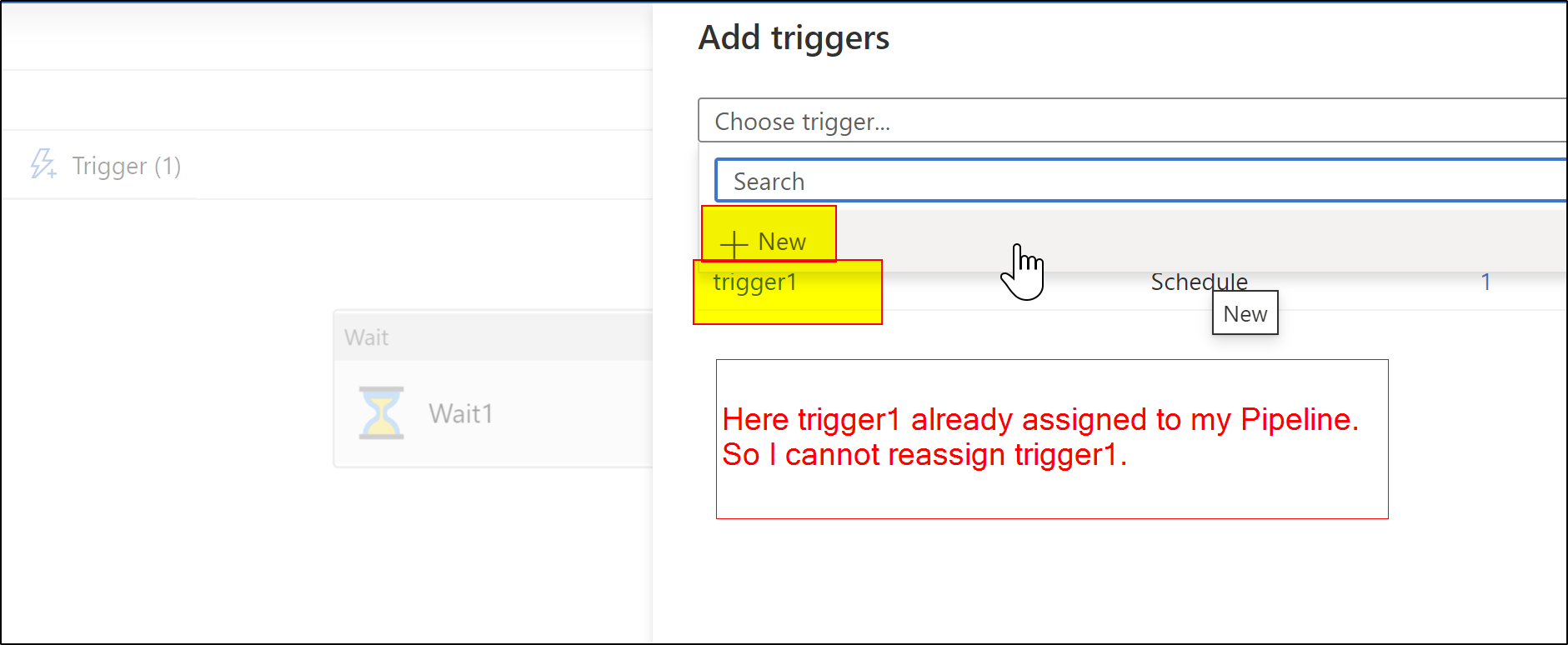

    Technically, assigning same trigger with different values to pipeline parameters is not supported in ADF.
    Please check below screenshot.

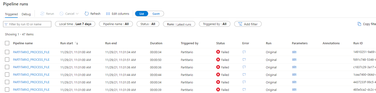

    But you mentioned to did that using json. I doubt, will it actually run pipeline multiple times with same trigger with different parameters. Could you please monitor your pipeline runs and confirm once?
