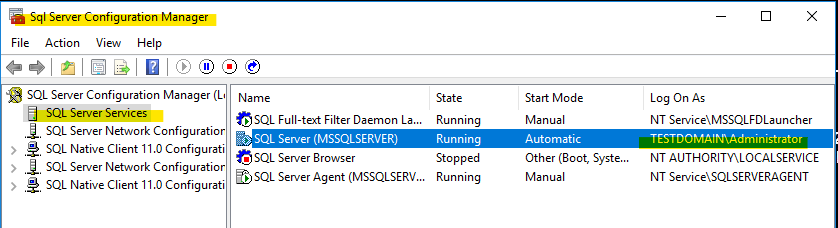

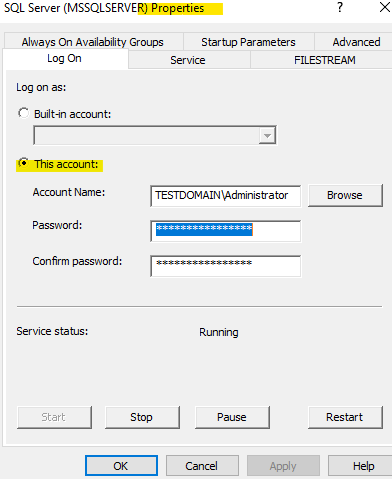

    Your error indicates that you may not use the same account on all machines. Check in the following way.
    You should log in with the same domain account on all nodes.
    In my case, my domain account password has expired or if I actively change it, there will be such an error.
    Finally, hope your problem could be solved.
