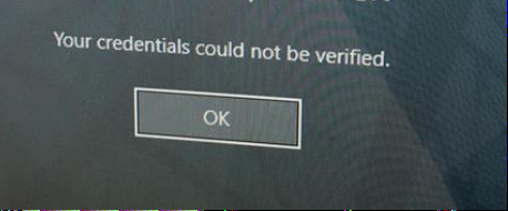

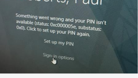

User A - WHFB - PIN Setup Successful , PIN Login successful , I can verify from the Azure AD sign in logs that the authentication is windows hello for business.
User B - PIN Setup Successful, PIN Login Unsuccessful , getting the below errors ( I need assistance in resolve these errors or provide a direction , will be much appreciated.)
1) Your credentials could not be verified
2) Something went wrong and your PIN isn't available ( status:0xc000005e, substatus:(0x0) Click to set your PIN again.

    Self - Resolved after following the below steps :
    1) I deleted the NGC Folder ( C:\Windows\ServiceProfiles\LocalService\AppData\Local\Microsoft )
    2) Deleted the enrolled WHFB authentication method
    Asked the user to Re-enroll for Windows Hello for Business and it enrolled successfully.
