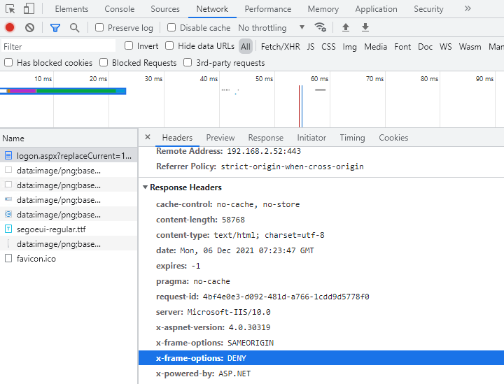

    After the configuration, can you see this header via browser?
    If it is present, the header should have been added successfully.

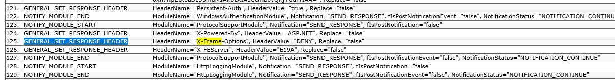

    To confirm it, you may also Enable Failed-Request Tracing in IIS.
    Under the Compact View tag of the xml files, please look for the GENERAL_SET_RESPONSE_HEADER event.
    If you can see this event, the header should have been added successfully.
