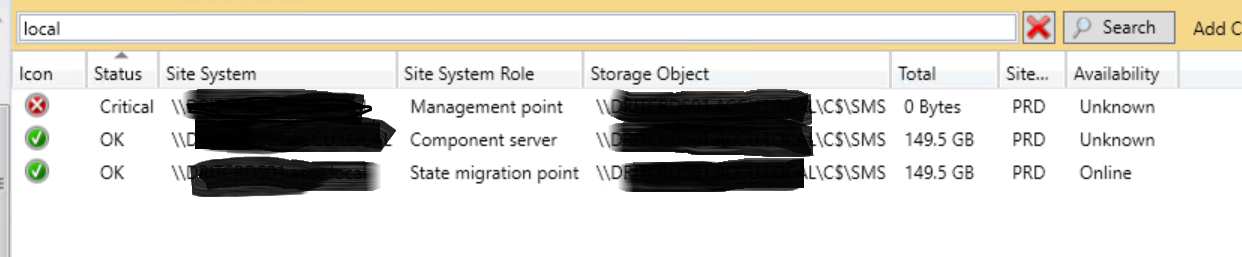

we have SCCM environment in Doamin A, with remote DB. Configuring MP on Untrusted domain B.
Getting below error. Can suggest me to fix this error.
Example
SCCM PS - Server1.A.com
SCCM MP - Server2.A.com
SCCM DB - Server3.A.com
SCCM DP - Server4.A.com
SCCM MP - Server1.B.com (Which is configuring & getting error)

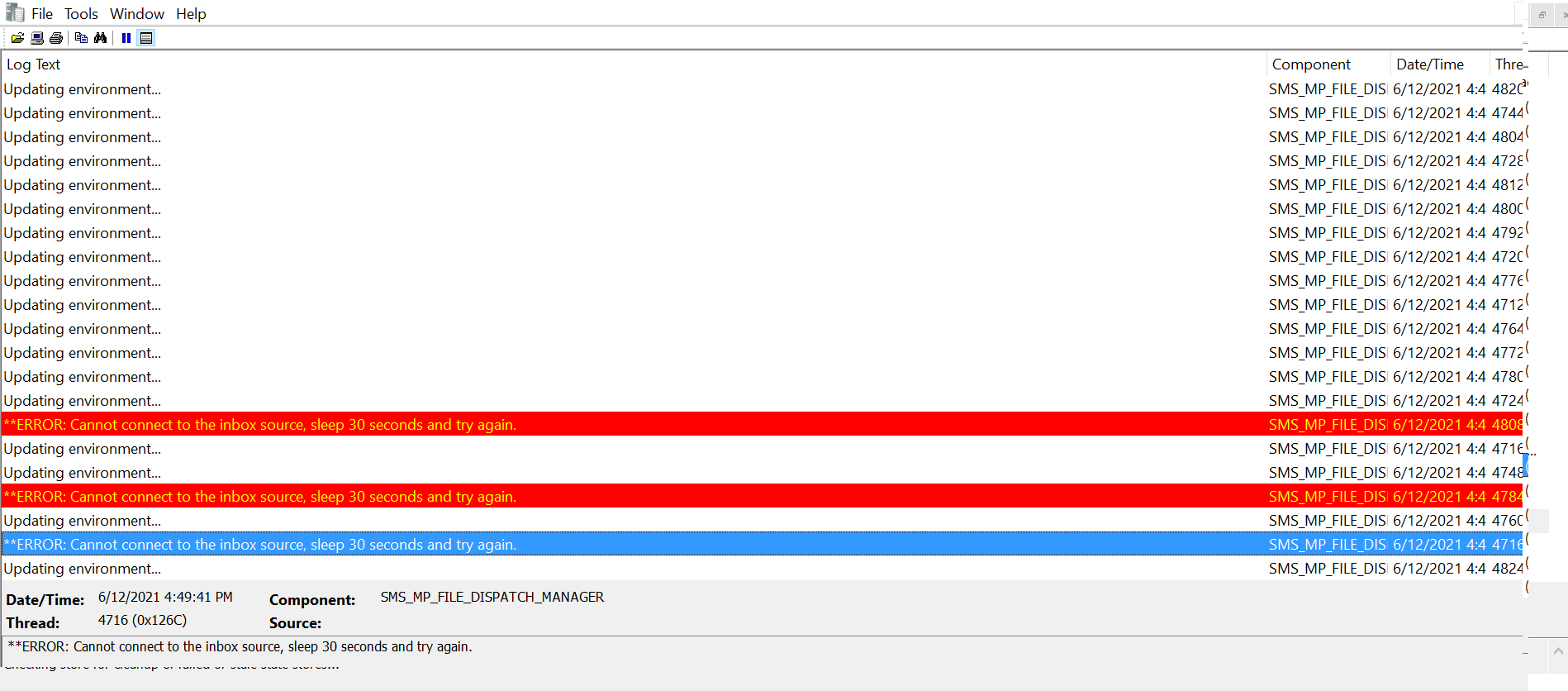

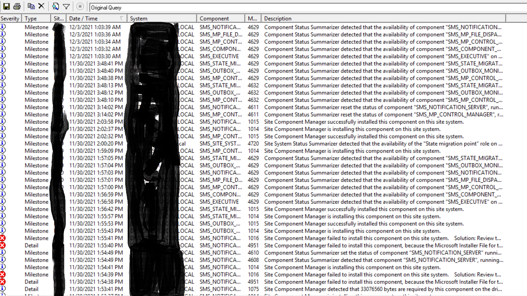

Beow are the logs.
Site Component Manager failed to install this component on this site system.
Solution: Review the previous status messages to determine the exact reason for the failure. Site Component Manager will automatically retry the installation in 60 minutes. To force Site Component Manager to immediately retry the installation, stop and restart Site Component Manager using the Configuration Manager Service Manager.
Site Component Manager failed to install this component, because the Microsoft Installer File for this component (bgbisapi.msi) could not install.
Refer to the BgbSetup.log, the bgbisapimsi.log, as well as the ConfigMgr Documentation and the Microsoft Knowledge Base for further information.

    Hi @Vij ,
    It seems that there is something wrong with some component on the MP. The installation of MP is successful.
    According to the information, the Microsoft Installer File for this component (bgbisapi.msi) could not install, we could check BgbSetup.log and bgbisapimsi.log to see if the component is installed successfully.
