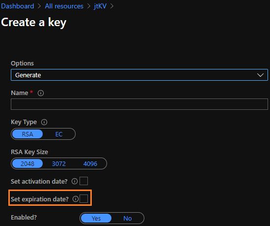

    This issue is more related to the actual Salt Key, than the Azure Key Vault since you're not using Azure to encrypt passwords. You're only storing keys/secrets, and utilizing the ClientID/Secret to encrypt your passwords manually. Additionally, it sounds like your main concern is - when you do rotate salt keys, can you decrypt the existing string with the new salt key.
    From my understanding of key rotation, as I stated previously:
    If you're encrypting your passwords, i.e. Password1 with SaltKey1: you want to rotate SaltKey1 to SaltKey2, you'll have to decrypt Password1 with SaltKey1 and re-encrypt Password1 with SaltKey2; or re-encrypt Password1 with SaltKey2. Otherwise, there'd be no way to decrypt Password1 with SaltKey2 since it was originally encrypted with SaltKey1.
    • The key point is, if you plan to rotate keys, you should decrypt any old strings prior to rotating keys. Once the salt key is rotated, you can then re-encrypt those strings with the new salt key.
    • If you rotate keys prior to decrypting/re-encrypting, you need to somehow "reference/re-encrypt" that password with the new key.
    You also have the option of not having your keys/secrets expire.
    However, if your salt key is compromised or if you plan to rotate these keys periodically you'll most likely have to go through one of the decryption/encryption scenarios I stated above.
