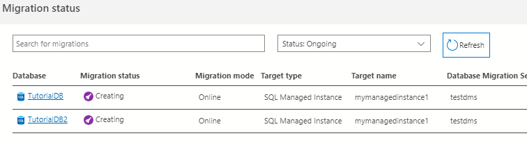

I have tried to migrate 2 databases from onpremise SQL server to Azure Managed Instance using ADS with DMS. Migration summary page is showing 2 databases but the migration is happening for only one database only and also status is showing only 1 database. Pls refer below the screenshot and advise if any setup need to do.

    @Santhamoorthy M Good to hear that you were able to migrate now and thanks for sharing your solution,
    You can also try as below
    Move backups to a storage account -> Blob storage type
    1. Create a credential using a SAS token to connect to the blob storage
    2. Restore the databases.
      --Example-MI
      USE master
      CREATE CREDENTIAL [https:/yourstorageaccount.blob.core.windows.net/Container inside blob storage]
      -- this name must match the container path, start with https and must not contain a forward slash at the end
      WITH IDENTITY='SHARED ACCESS SIGNATURE'
      -- this is a mandatory string and should not be changed
      , SECRET = 'SASToken'
      -- this is the shared access signature key that you obtained in section 1.
    -- Validate if you have access to the blob storage
    RESTORE FILELISTONLY FROM URL = 'https:/storageaccount.blob.core.windows.net/container/backupname.bak'
    RESTORE DATABASE dbname
    --check Restore status because STATS parameter doesn't work
    SELECT session_id as SPID, command, a.text AS Query, start_time, percent_complete
    , dateadd(second,estimated_completion_time/1000, getdate()) as estimated_completion_time
    FROM sys.dm_exec_requests r
    CROSS APPLY sys.dm_exec_sql_text(r.sql_handle) a
    WHERE r.command in ('BACKUP DATABASE','RESTORE DATABASE')
    You can also try as mentioned above
