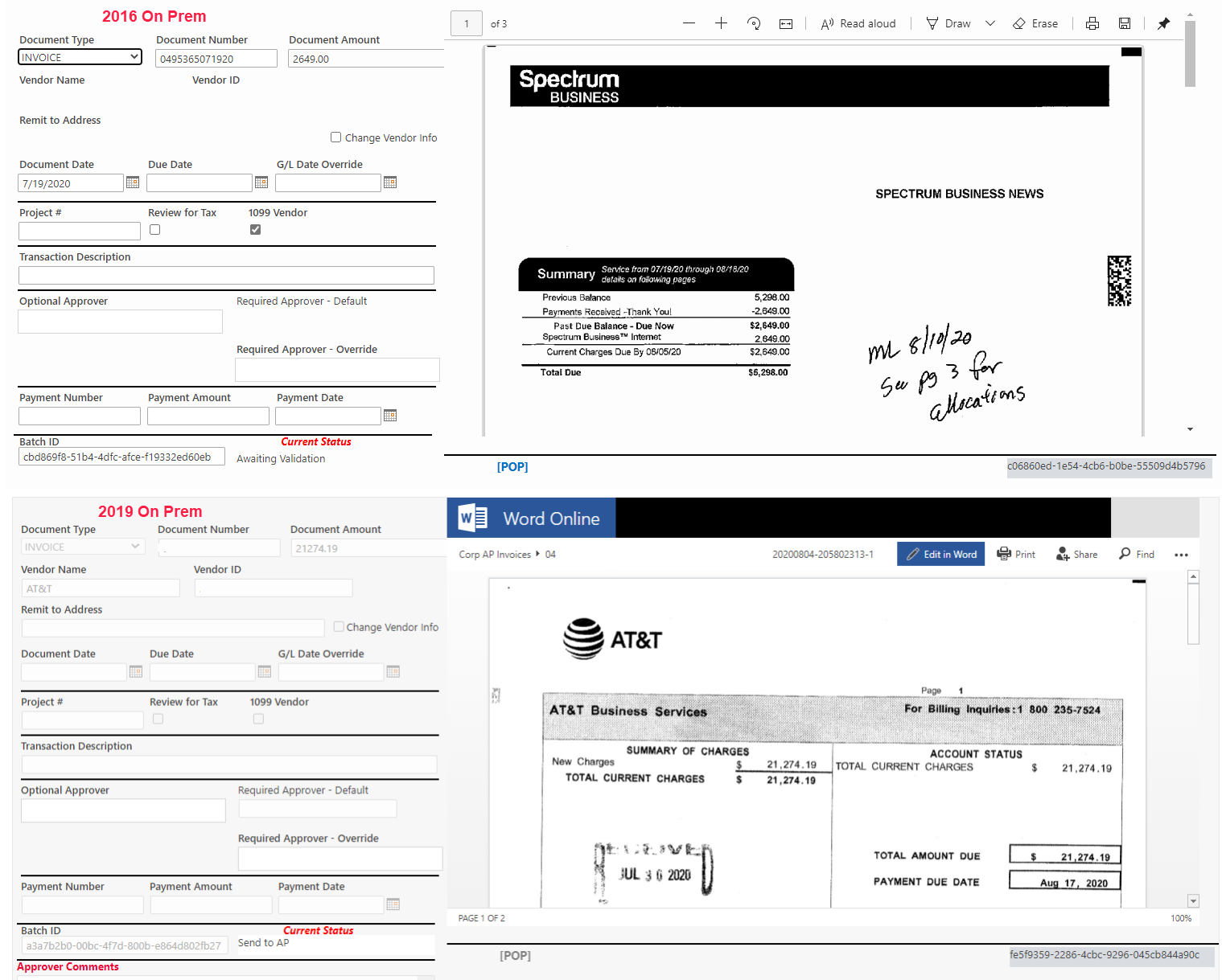

How do I open pdf in the browser without using "WordPDF". I have SharePoint 2019 on Prem. I have tried changing every SPWOPIBinding to make this happen, but nothing works. I also tried the following..
  • In Central Admin, I change the Browser File Handle to Permissive.
  • On my pc I changed the default for PDF's to open via Edge.
  • When The library default is set to Open in the Client Application, the PDF file is downloaded. (I want the file to open in browser)
  • When the library default is set to Open in the browser the PDF opens in Word Online.
This is working fine when using browser IE, but I believe this is due to the Add-on in ID; Adobe Acrobat SharePoint OpenDocuments Component.
This also works fine in 2016 using Edge, Chrome or IE.
I prefer my users use Edge or Chrome.
I want SP 2019 to show the PDF like it does in SP2016
Please see attachments

  2. Stacey McBeth 1 Reputation point
    2020-08-13T15:21:16.29+00:00
    I did all you listed above.
    I removed the binding, the files download, will not open in PDF Viewer
    I add the binding and the pdf's show in word.
    I found this article..
    https://learn.microsoft.com/en-us/sharepoint/what-s-new/what-s-deprecated-or-removed-from-sharepoint-server-2019#pdf-viewer-sharepoint-server-2019-preview
    PDF Viewer (SharePoint Server 2019 Preview)
    SharePoint Server 2019 Preview included a built-in PDF viewer which allowed SharePoint to render PDF documents. This feature was removed from the RTM release of SharePoint Server 2019. Customers can instead use the native PDF rendering capabilities available in most web browsers and client devices.
