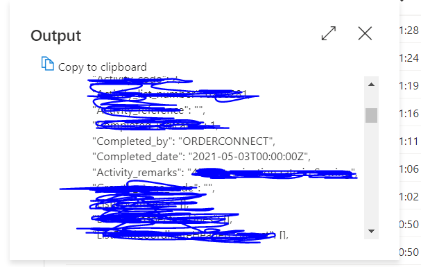

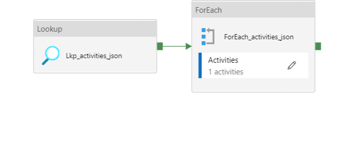

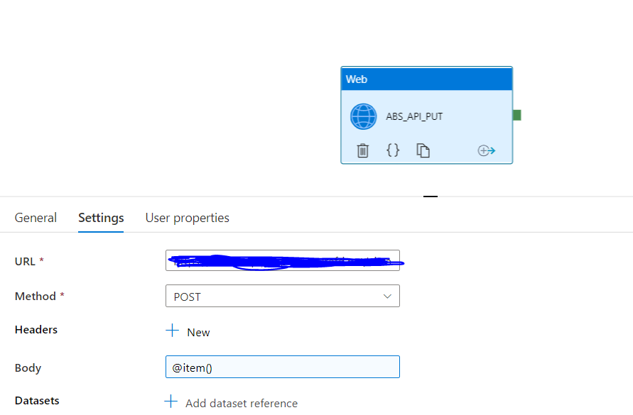

    The below screenshots tell you the flow. I use look up to call the json files and send each row into for each loop which has web activity.
