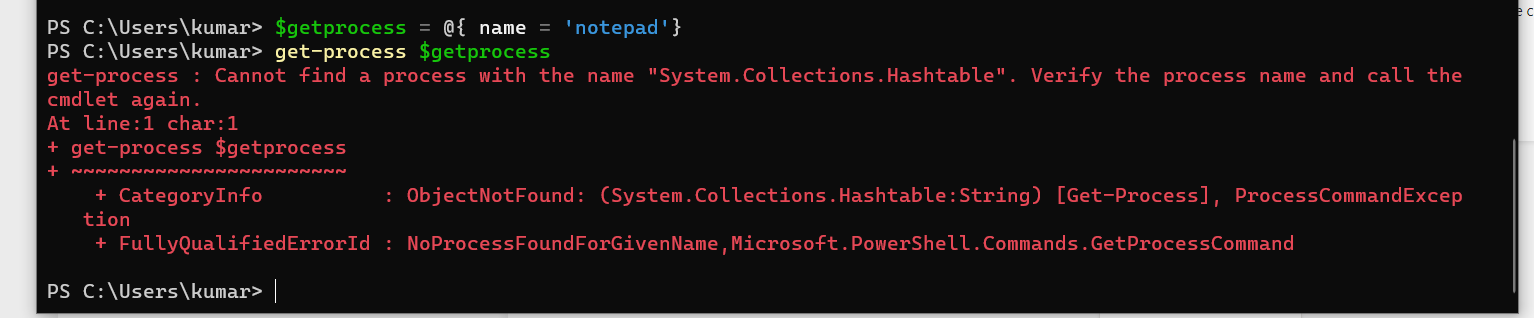

System collection error pops up when I wanted to use the parameter
Please help

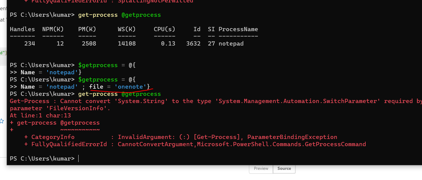

  1. Rich Matheisen 48,116 Reputation points
    2021-12-17T16:12:48.553+00:00
    Where did you get the idea that the "-File" (i.e. "-FileVersionInfo), which is a "SwitchParameter", takes a value of anything except $true or $false?
    Have you read the help for the Get-Process cmdlet? How about the -FileVersionInfo parameter of that cmdlet?

    Well, first, if you're going to use splatting you use a "@" and not a "$". Confusing? Yeah, a bit, but that's how it works.
    Second, it looks like there's a bug in the documentation.
    Looking at the documentation you'd assume that "name" as the key in a hash would match the -Name parameter. However, it does not. But, the documentation does list "ProcessName" as an alias for "Name".
    So, this works:
    $getprocess = @{processname = "notepad"}
    Get-Process @getprocess
