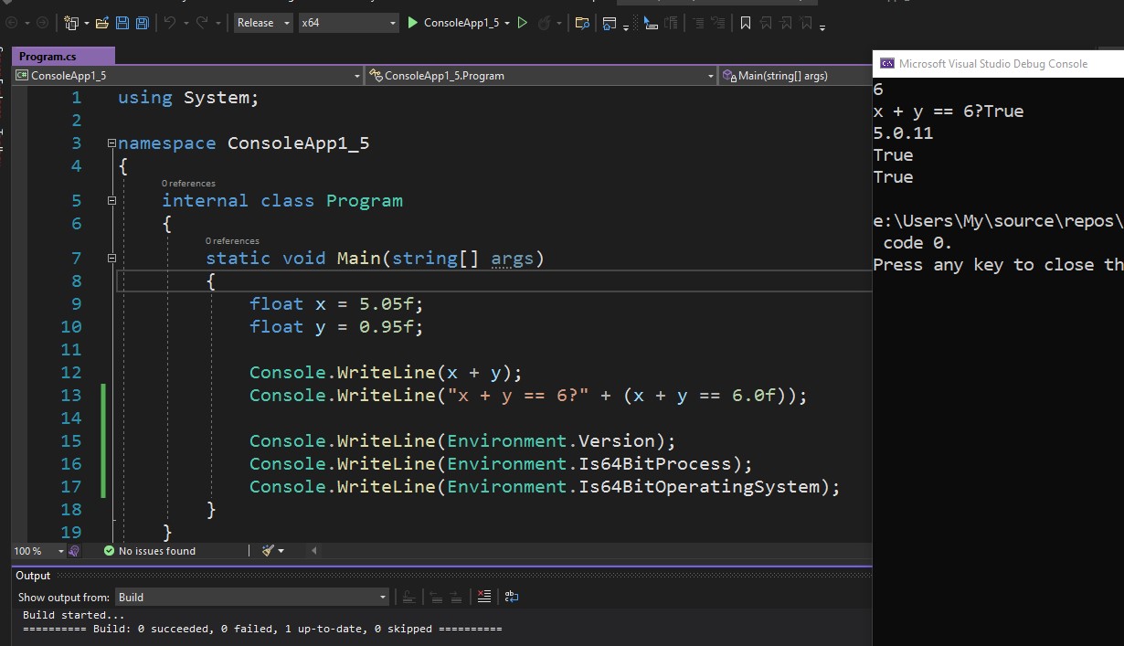

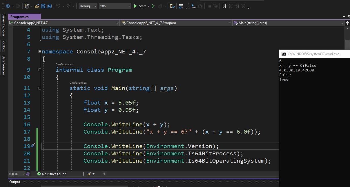

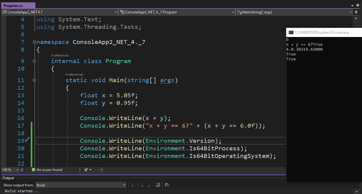

  3. Shervan360 1,681 Reputation points
    2021-12-18T08:14:38.273+00:00
    In .NET 5, both x86 and x64 generate true.
    In .NET 4.7, x86 generate false and x64 generate true.
    In addition to the x86 and x64, the .NET version seems to be important.
