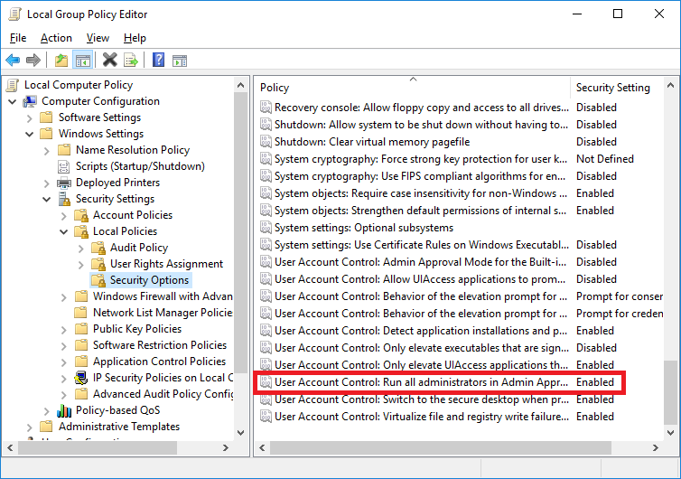

    2021-12-18T16:58:41.85+00:00
    Might check this one is Enabled
  4. Karl Burrows 1 Reputation point
    2021-12-18T17:03:53.66+00:00
    Yes, it's enabled. I think I tried every iteration of modifying local policies (which I also have to run as administrator to edit) and nothing. I have tried different GPO settings, etc. and nothing seems to stick. I had a similar issue with another Server 2019 migration earlier this year but only minimal issues that didn't interfere with running most of the server functions.
