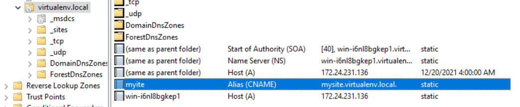

Last i have created DNS record:
Any suggestion is welcome.

    After creating the new site i needed to add entry in the hosts file. No DNS record was needed.
