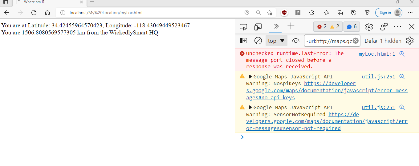

However when I enter localhost/My Location, it only displays the
distance-longitude and latitude. Google map does not display.

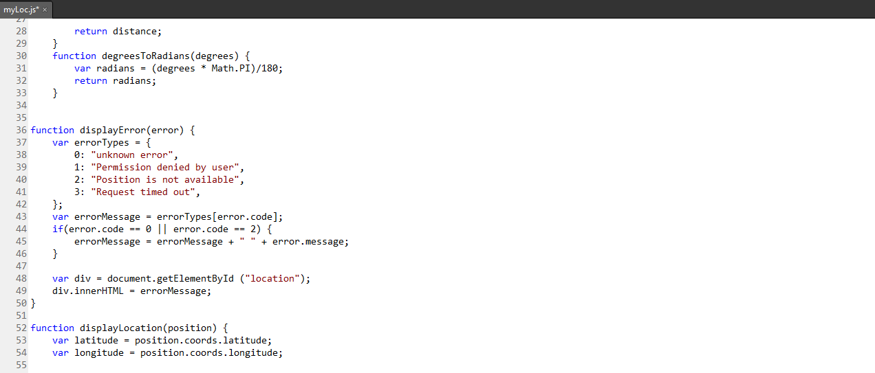

I also tried it a different way:
-Saved the folder My Location in wwwroot directory with three files myLoc.js, myLoc.html and myLoc.html in it.
-Added a website in IIS10.

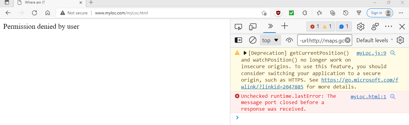

When I browse the website within IIs Manager I get Permission denied by user.

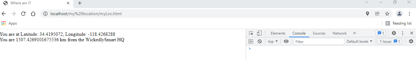

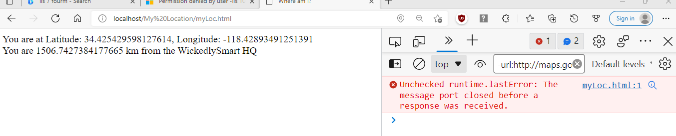

I tried this with google chrome, edge and firefox browsers. Neither one shows the map next to or under the distance info. And I get different error message with each.

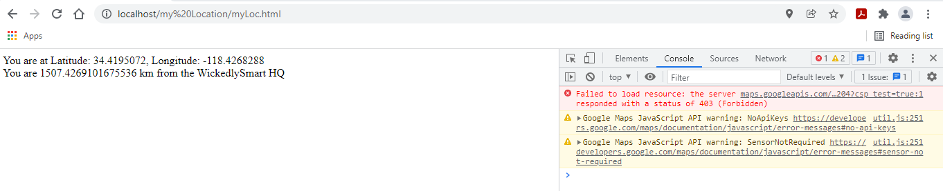

With the google chrome browser I get:
Failed to load resource: the server responded with a status of 403 (Forbidden)
This is using localhost within IIS 10 Manager
This is with Microsoft edge:
As you can see google map is not showing either way.

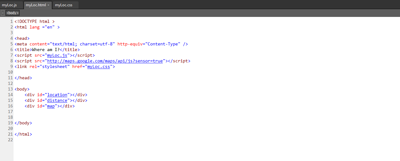

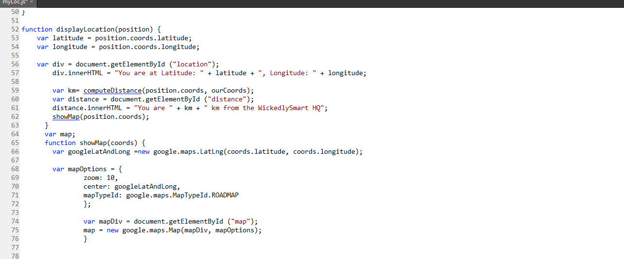

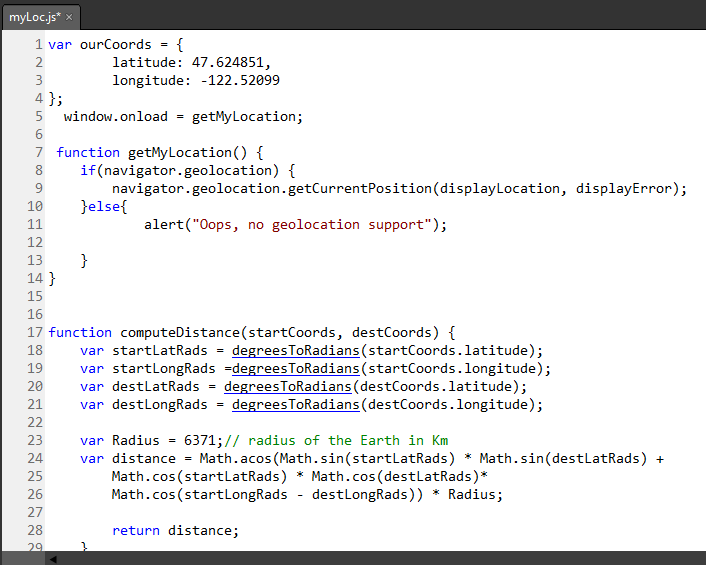

Here are my source codes:

  1. Sam Wu-MSFT 7,561 Reputation points Microsoft External Staff
    2021-12-22T02:15:10.373+00:00
    @Shervin Ghamghamy
    The problem should appear on the Google Maps APIs, As per Google announcement, usage of the Google Maps APIs now requires a key. If you are using the Google Maps API on localhost or your domain was not active prior to June 22nd, 2016, it will require a key going forward. You can refer to the Google Maps APIs documentation to get a key and add it to your application.
    Create a Google Maps API Key.
