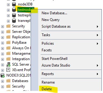

    By the way, you can also delete this database from SSMS UI as below screenshot.
