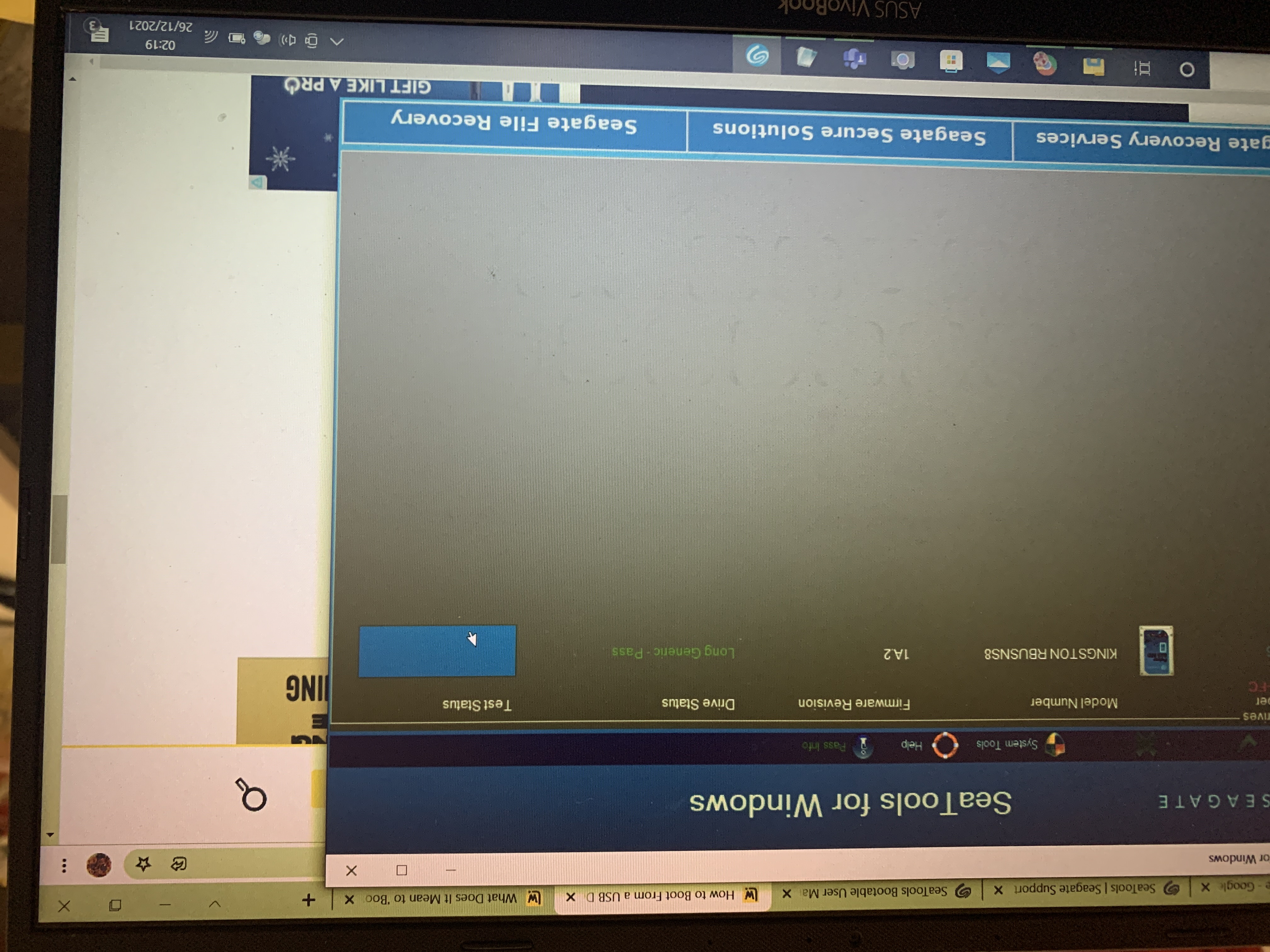

  3. BanderKat 1 Reputation point
    2021-12-26T02:20:04.33+00:00
  4. Docs 16,226 Reputation points
    2021-12-26T02:47:27.32+00:00
    Was that running Sea Tools for Windows on the working computer?
    The working computer displayed Sea Tools long generic pass?
    If you can create a bootable Sea Tools flash drive then you can move the flash drive to the problematic computer.
