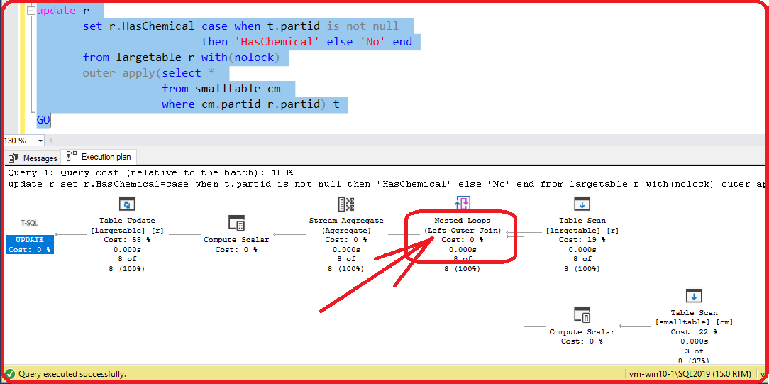

    Cannot use INNER JOIN instead of LEFT JOIN, try to use OUTER APPLY instead of LEFT JOIN:
          update r
          set r.HasChemical=case when t.partid is not null
                            then 'HasChemical' else 'No' end
          from ExtractReports.dbo.FinalComplanceDataDelivery r with(nolock)
          outer apply(select *
                      from Parts.ChemicalMaster cm
                      where cm.partid=r.partid) t
