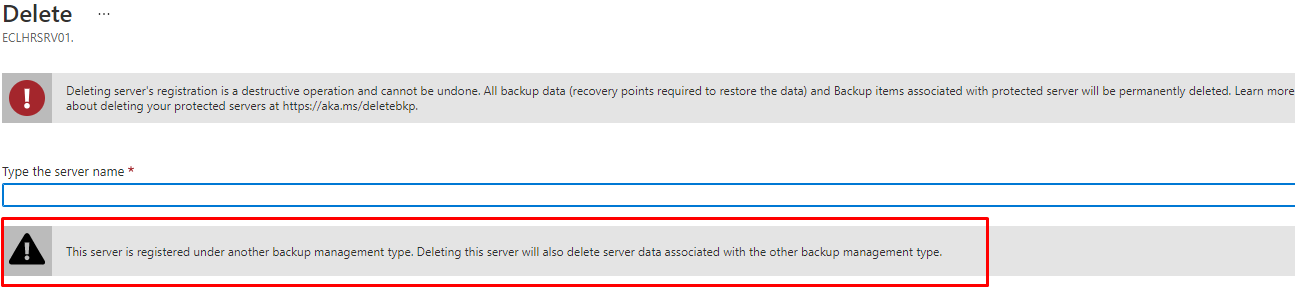

May I know what risk can I get from this message? I am trying to delete MARS agent from the portal. I've watched videos online on how they do it but I dont see the message as below. I only have agent as backup management type

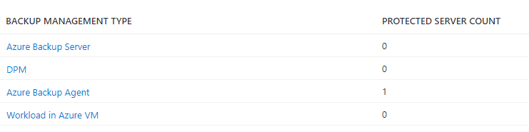

    As per screenshot, you are using Azure backup agent and there is one server protected (meaning, being backed up to Azure). If you are planning to remove/delete the protected server, the backup data associated to that server will also be deleted from recovery services vault (RSV). Once this delete operation is performed, there will be no data in the cloud for that particular server. Here is the guide you can refer to - https://learn.microsoft.com/en-us/azure/backup/backup-azure-delete-vault?tabs=portal#delete-protected-items-in-the-cloud
    Recommendations: For production servers protected with Azure backup, it is not recommended to delete server unless you have a backup plan in place.
    If this is a test server and you want to delete it after testing Azure backup, you can go ahead and complete the deletion task.
