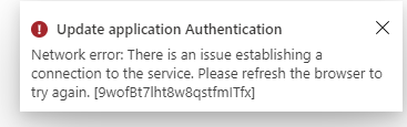

I am trying to expose an API of an App registered with Azure AD with Multitenant architecture.
But when I am trying to set the "App ID URI" its giving me the following error:
How to fix this error?

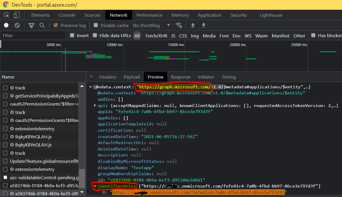

    Are you using a VPN client or a proxy to connect to the internet? Because this is most likely a network connectivity issue, I would recommend that you to verify that https://graph.microsoft.com/v1.0/ is whitelisted, as you may see graph endpoint called when I expose an API (aka identifieruri) from browser Devtool .
    Try using incognito / InPrivate browser to check the behavior across different browser and lets know the outcome. Thanks.
