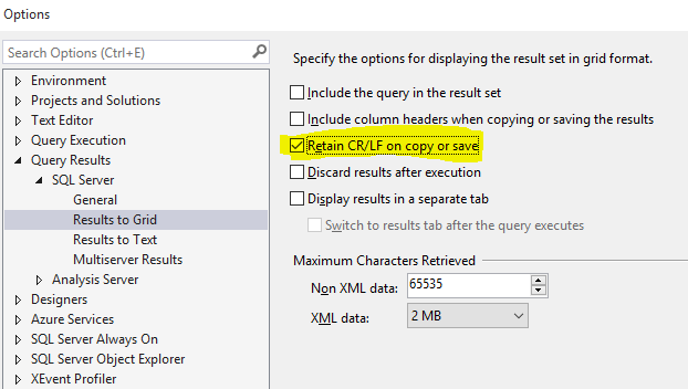

  1. Ahsan Kabir 76 Reputation points MVP
    2022-01-02T21:13:49.487+00:00
    Notes 1 :Use only CHAR(13)
    declare @testtext nvarchar(max)
    set @testtext = 'Line 1' + CHAR(13) + 'Line 2' + CHAR(13) + 'Line 3'
    select @testtext
    Notes 2 : Have check setting
