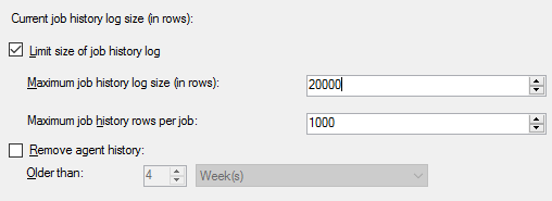

1) SQL Server agent properties looks like this:
[Tried changing these numbers to a higher value and did a SQL Agent restart – No help!]
